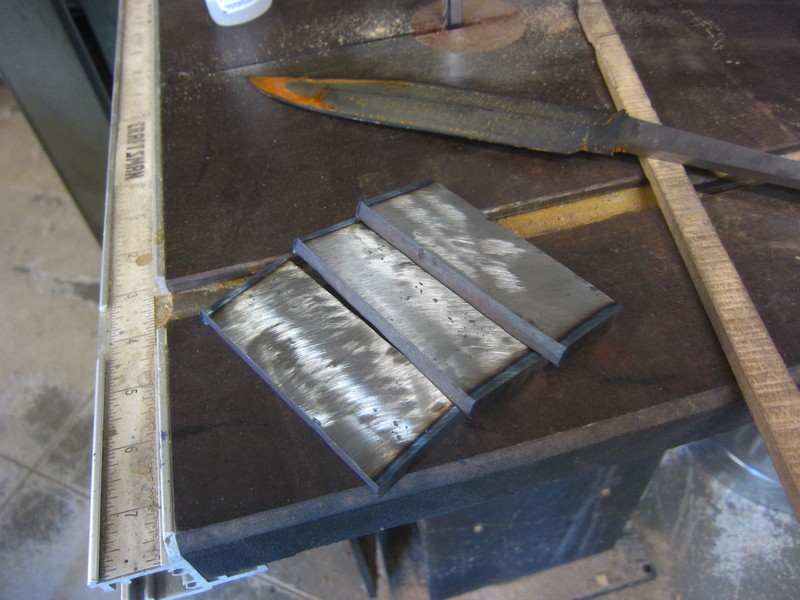

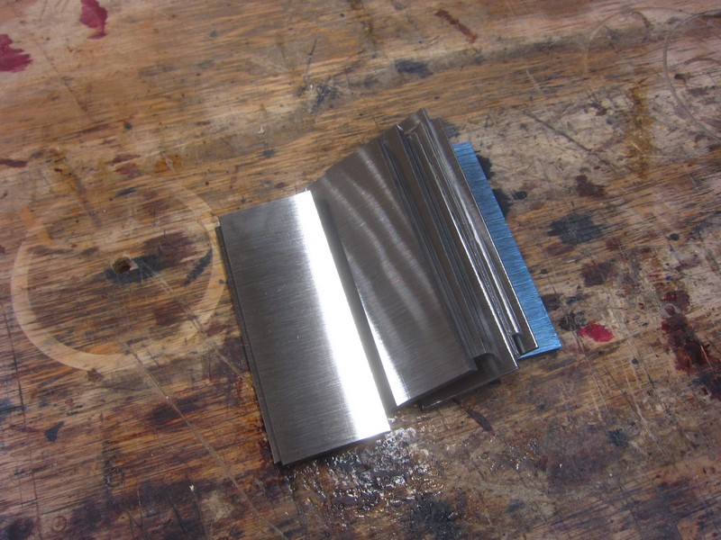

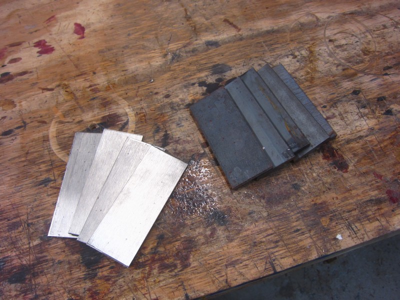

So, for this billet, I started out with 9 layers of steel. 5 layers of 1084 (plowshare steel) and 4 layers of 15n20 (Swedish bandsaw steel). The 1084 has a lot of manganese in it, which makes it etch dark, and the 15n20 has nickel in it, which makes it etch very light. The two together make for great contrast.
Here are the pieces cut to length. I like to work with 4" long billets:
Notice the layers of 15n20 are much thinner than the 1084:

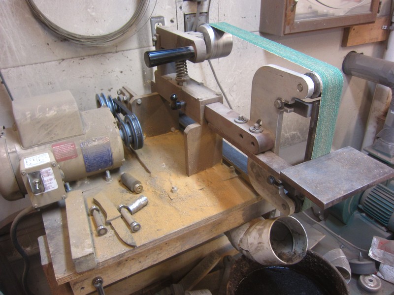

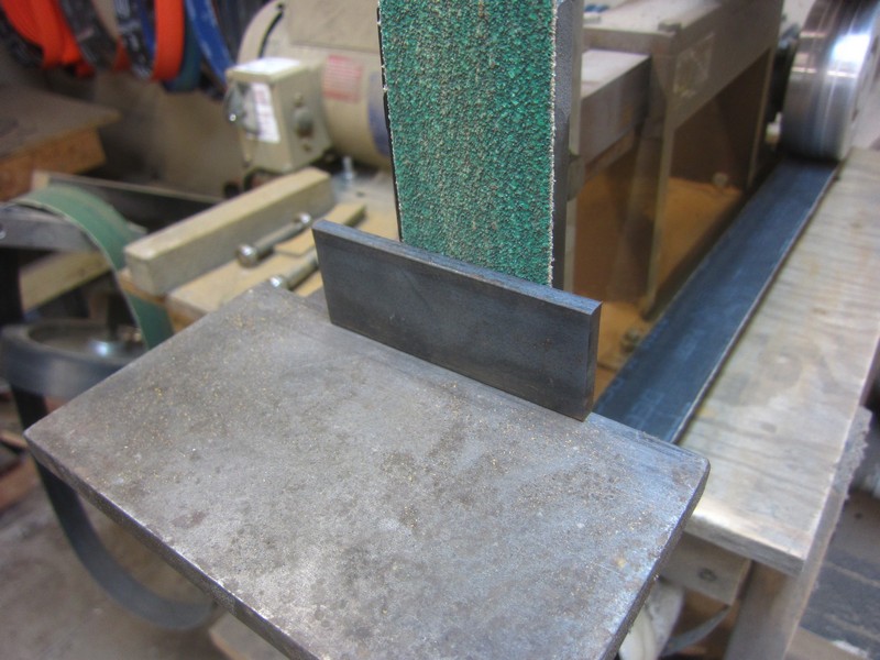

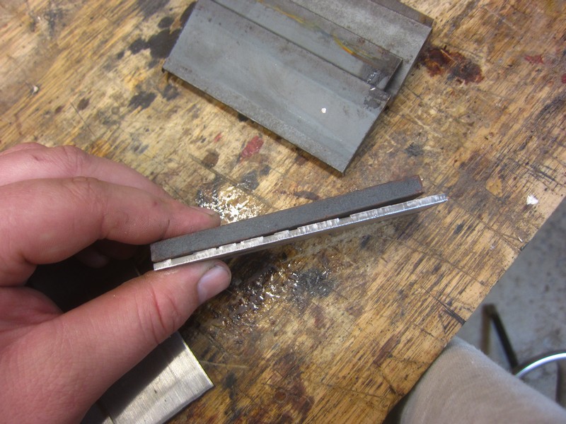

Before assembling the billet, the pieces have to be ground clean. Some people skip this step, but I prefer to not to make the flux work harder than it has to.
Here's my grinder:
Done grinding:

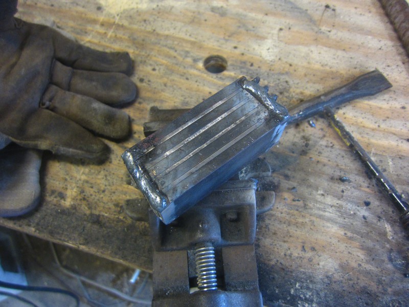

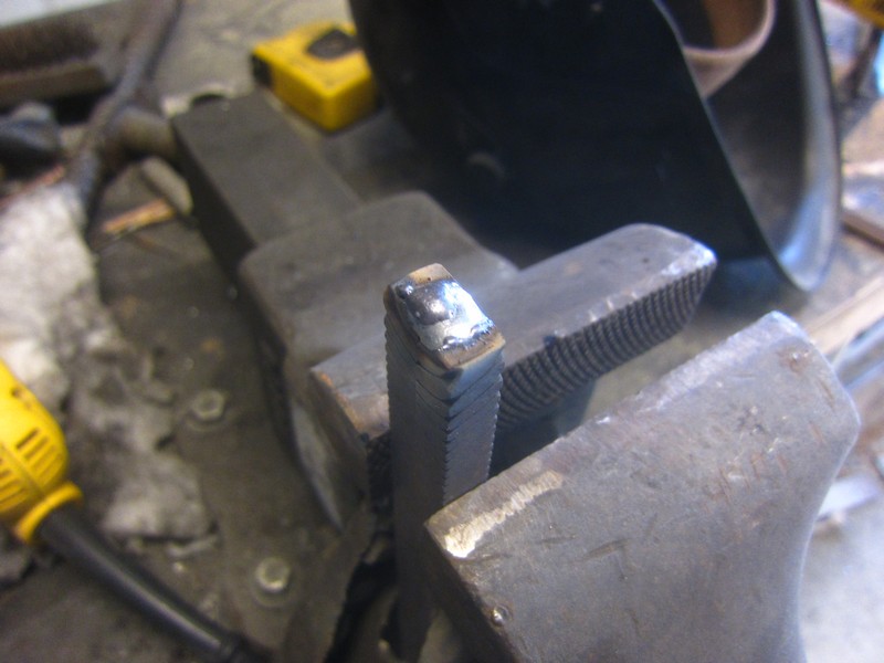

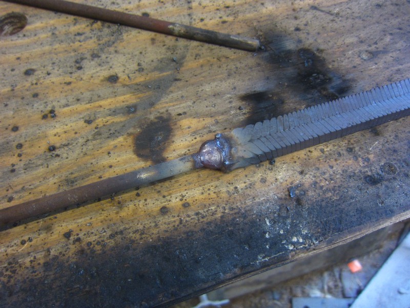

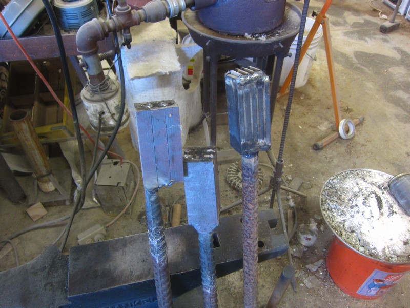

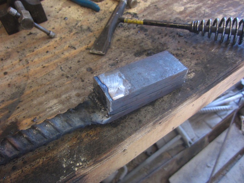

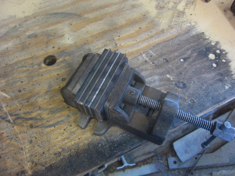

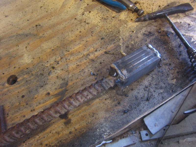

Now the pieces are clamped in a vise:
and the corners are welded together with a stick welder:
Then a length of re-bar is welded on as a handle:

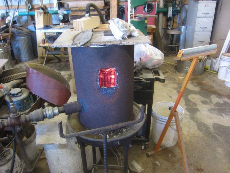

The forge heating up:
This here is my biggest fan:

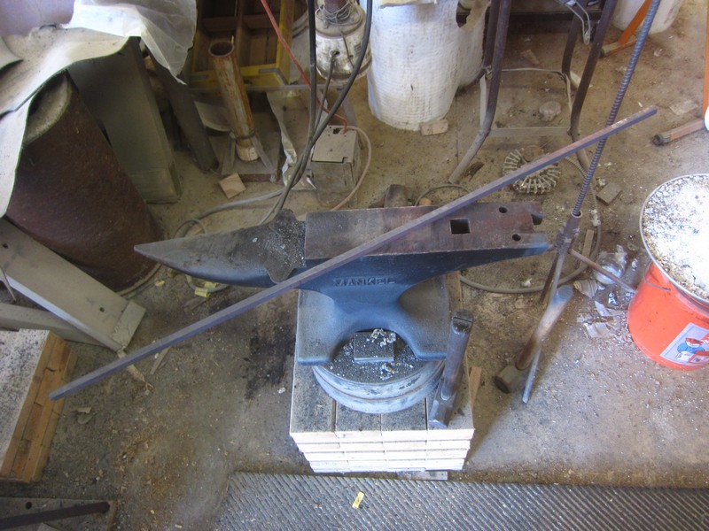

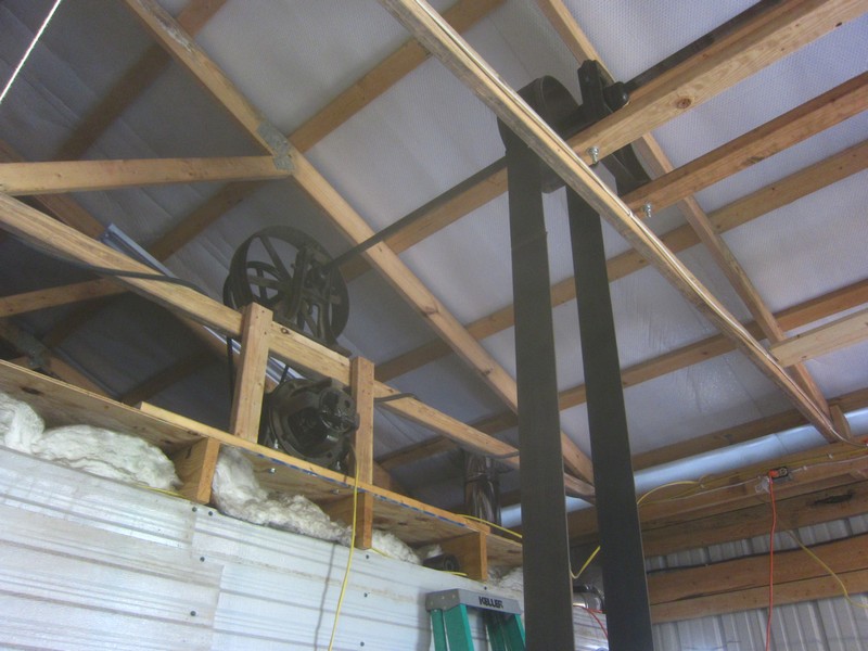

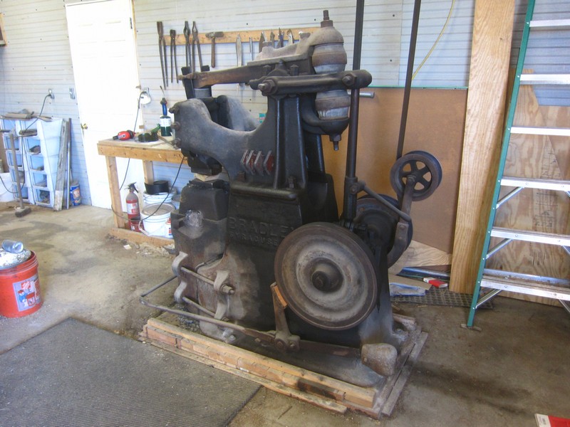

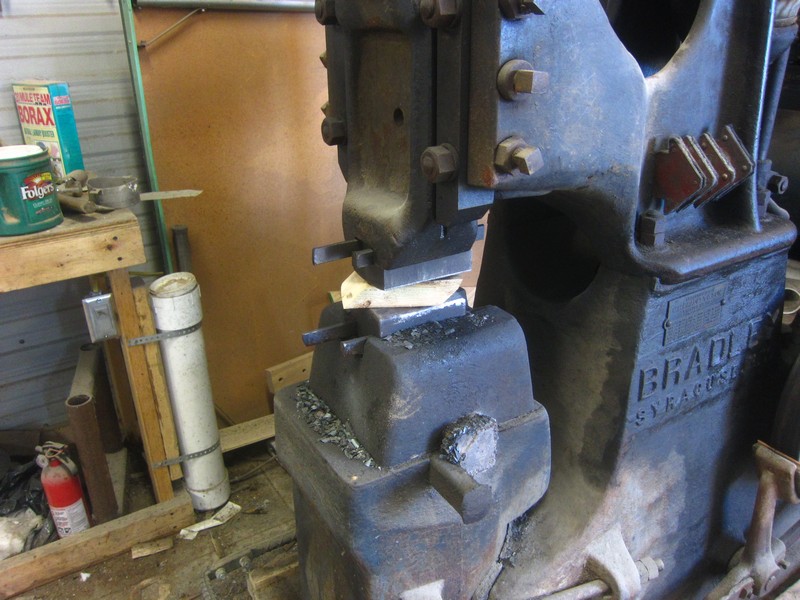

Some pics of my power hammer. I got this about a year and a half ago. Before that I had a small pneumatic hammer that I had built. This one is so much nicer. It's about 100 years old, and will still be running when I'm gone. I'd say they don't make 'em like they used to, but they don't make 'em at all anymore...
The business end. You don't want to get your fingers under there:
It runs off of an overhead lineshaft:
I worked three billets yesterday. The two on the left will be used for knives, and will probably end up as Turkish Twist. The one for the chisel will be Gordians Knot pattern.

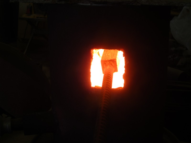

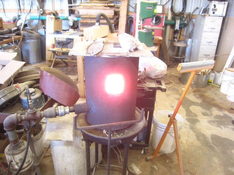

The forge is now up to temp. (About 2500 degrees F)
So the billet is inserted:
I was too busy to get pictures of the following steps, so here's a quick synopsis.
When the billet starts to glow (about 1300 F) I sprinkle the billet with flux, which is a mixture of borax and boric acid. The purpose of the flux is to dissolve dirt and impurities, and to exclude oxygen. When the billet gets hot enough all the way through, it is then hammered or pressed, and the flux gets squeezed out, hopefully taking any junk with it. If it's all done right, you'll end up with one solid piece, with perfectly clean weld joints.
Here's a video of me doing a similar weld a year or so ago:
http://www.youtube.com/watch?v=EA_zXRG- ... ature=plcp
Here is the billet welded and drawn out to 16" long:

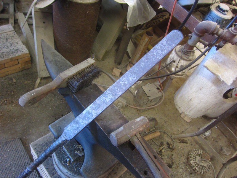

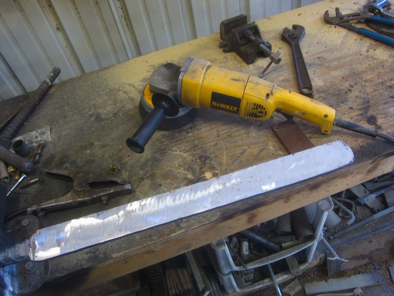

Now the scale (layer of oxidized steel) is ground off with an angle grinder:
and it's cut into 4 pieces 4" long:
The fourth piece is still attached to the handle...
The pieces are again ground clean and smooth on the belt grinder, and tack welded together:

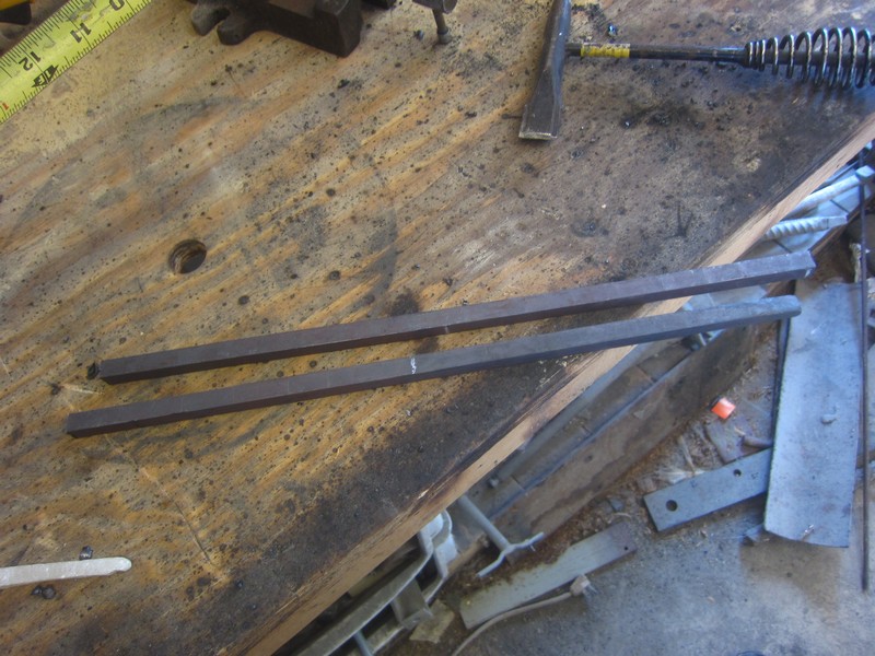

Then it's welded under the hammer again, and drawn out to a piece that's 1/2" square. It ended up exactly 40" long:
Then I cut it up into 2 pieces 16" long. Which leaves an extra 8" piece to use for something else. [:Y:]

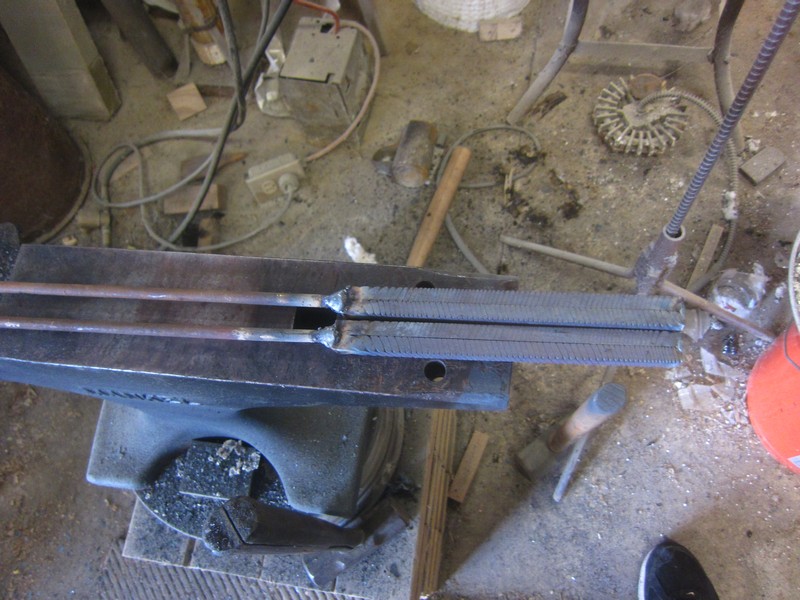

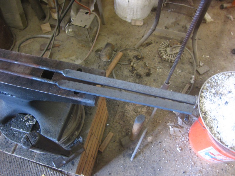

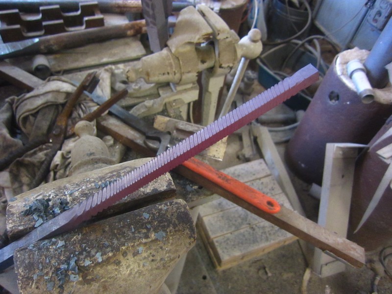

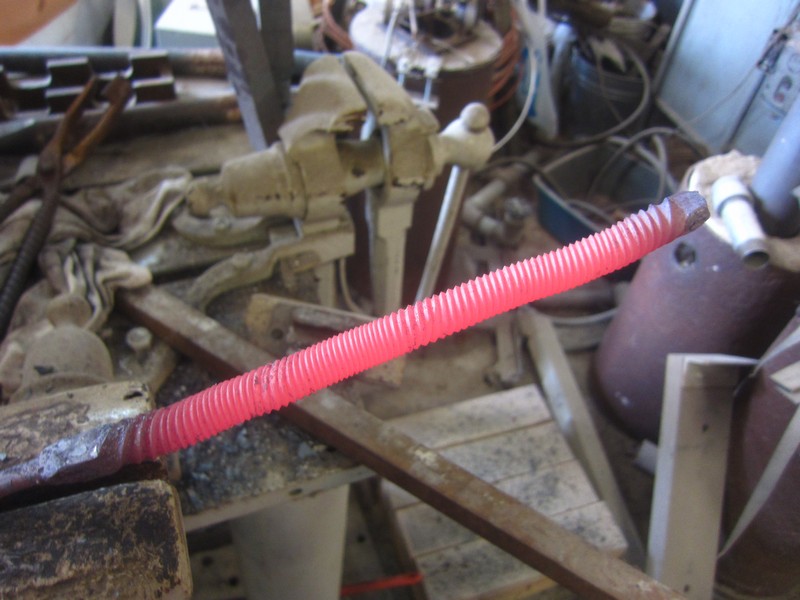

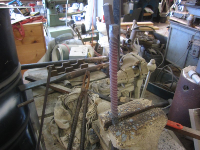

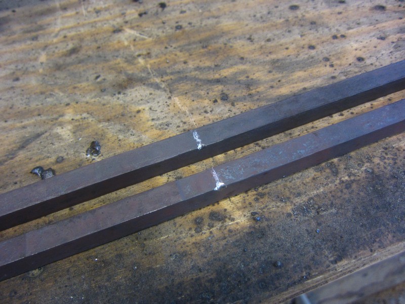

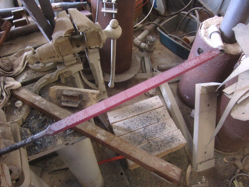

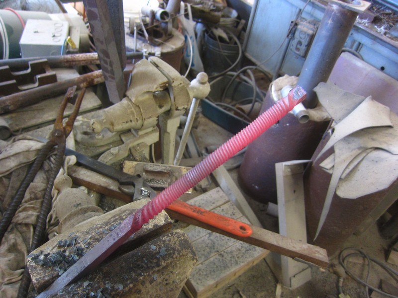

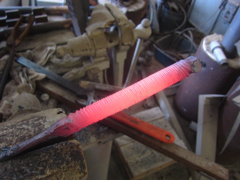

Picking up where I left off, we have two bars, about 18" long, with 33 layers each. They'll eventually be cut in half, but for now, it's much easier to do the next steps while they're longer.

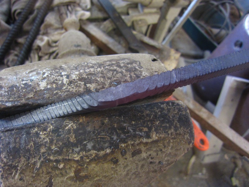

So, then next step is to mark each bar in the middle. This is so I know where to clamp it in the vise. To mark it, I nick it with the angle grinder, because soapstone doesn't show up well at 2000 degrees:
Now one half is heated up good and hot, then clamped in the vise and twisted. It's important to know when to stop twisting, because as the steel cools down, it becomes less malleable, but if you keep going, you'll break it. That's only happened to me once, but it was enough.
I twisted each bar a total of 15 full turns. I took 3 "heats" to do it, so about 5 twists per heat. You can see my twisting tool behind the vise in this pic:
When we reach the right number of twists, the billet is forged square again:
Then it's all repeated for the other half of the bar, but this time it's twisted the other direction:

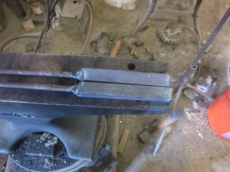

Now the bars are cut in half, ground clean on one side, and tack welded together on the ends:
Then handles are welded on:
Just before forge welding:
Just after:

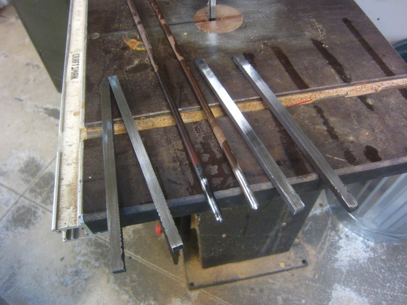

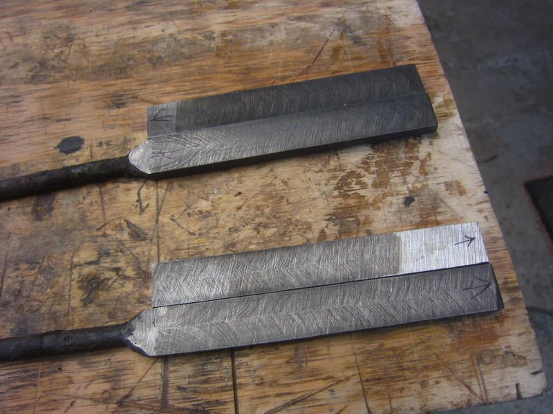

Then the billets are once again ground clean, and cut in half. Then I etch them a little bit so I can see which way the twists are going:
That's because it's important to stack them right for the last weld. You want clockwise twisted bars diagonally across from each other when looking at the end of the bar. Hope I'm making sense here...
Once I know how they're supposed to go together, they are tack welded one last time, and forge welded again:
Then the resulting bar (which has four bars, two each twisted clockwise and counter clockwise) is twisted again. It doesn't matter which way. For these two, I did one clockwise and the other counter clockwise, just to see the difference.
This is the counter clockwise billet, and I'll be making a knife out of it.
Then the chisel billet is forged flat. I'm leaving it fairly thick, because I want to grind it clean before final forging.
